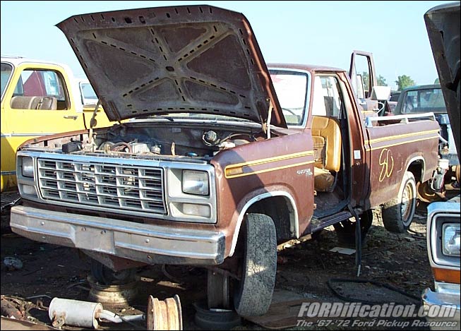

Just grab the pump and bracket from any '70s-'80s Ford truck with a 300...everything will bolt right up. Also, be sure to get the fan pulley and the lower crank pulley (which doubles as the harmonic balancer).

Im sure this works. Even to add an a/c compressor. Norhing really special. Just get all the stuff from a newer 300 engine.
