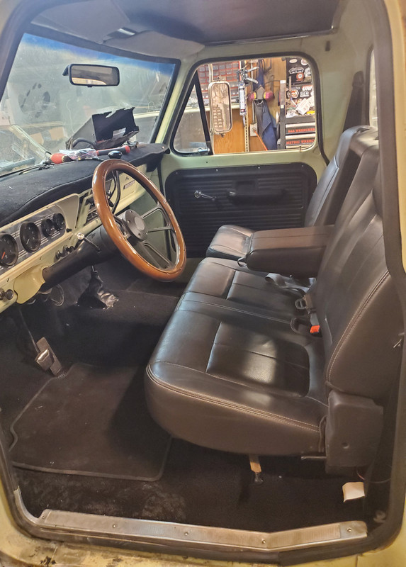

Finally had some time to spend a day working on my F100! Swapped my Lokar shifter over from a transmission mounted, to a floor mounted, cable shifter for the 4L80E.
With that done, I installed the new carpet, shifter boot, seat and new shoulder seat belts. Next up, mount the throttle and start wiring.

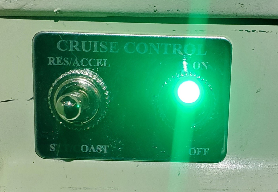

Everything is working great, except the cruise control. I suspect that is because of my L.E.D. brake lamps. I'll have to switch back to regular 1157s or add a resistor.

Resolved my cruise control functionality. Sure enough, the LED tail lamps did not have adequate resistance for the ECU. Swapped out for incandescent 1157 bulbs and all is well... now to decide if I want to run the LEDs and a resistor (then deal with the heat of the resistor under the dash) or just forget it and run the 1157s....
