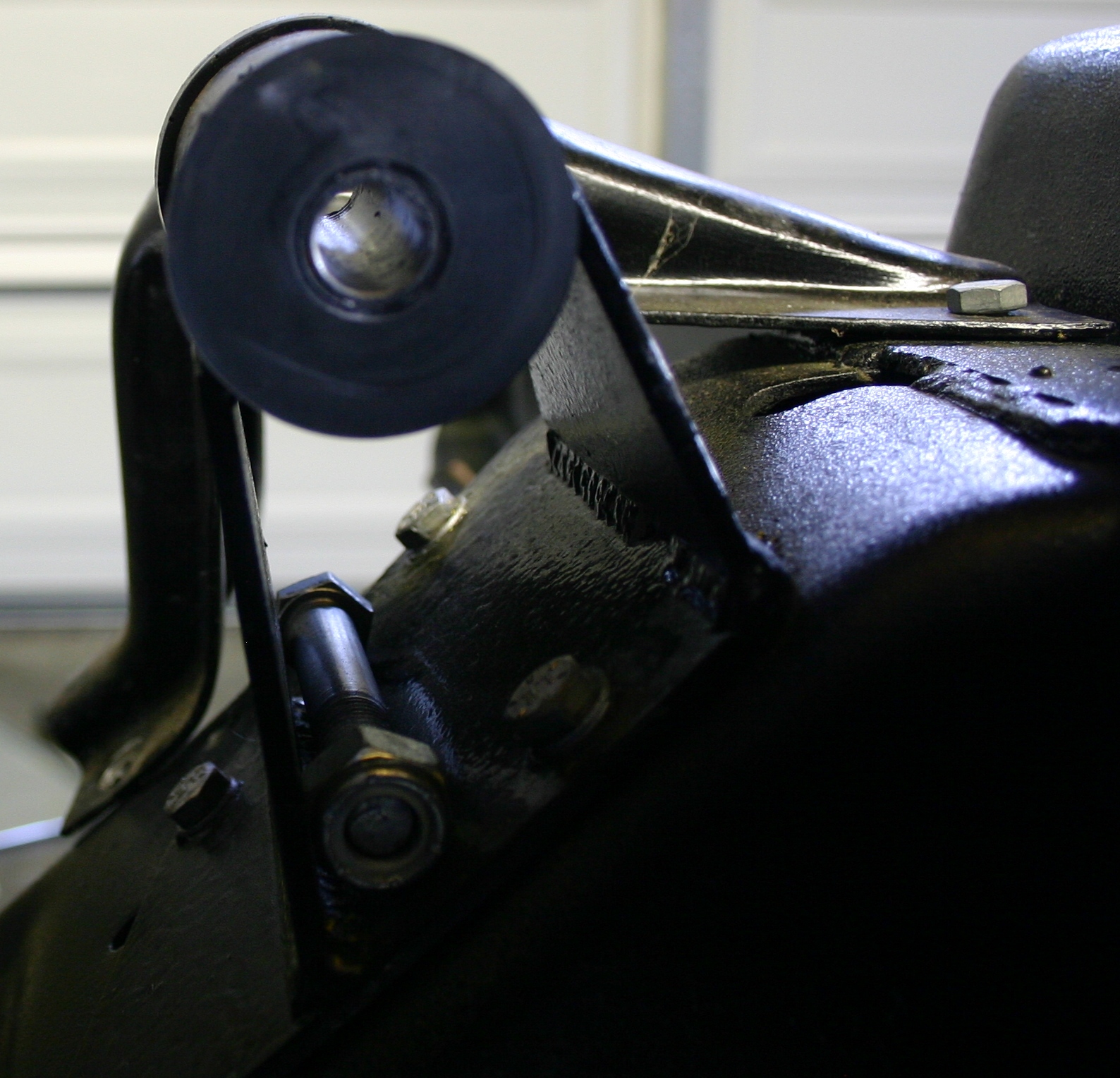

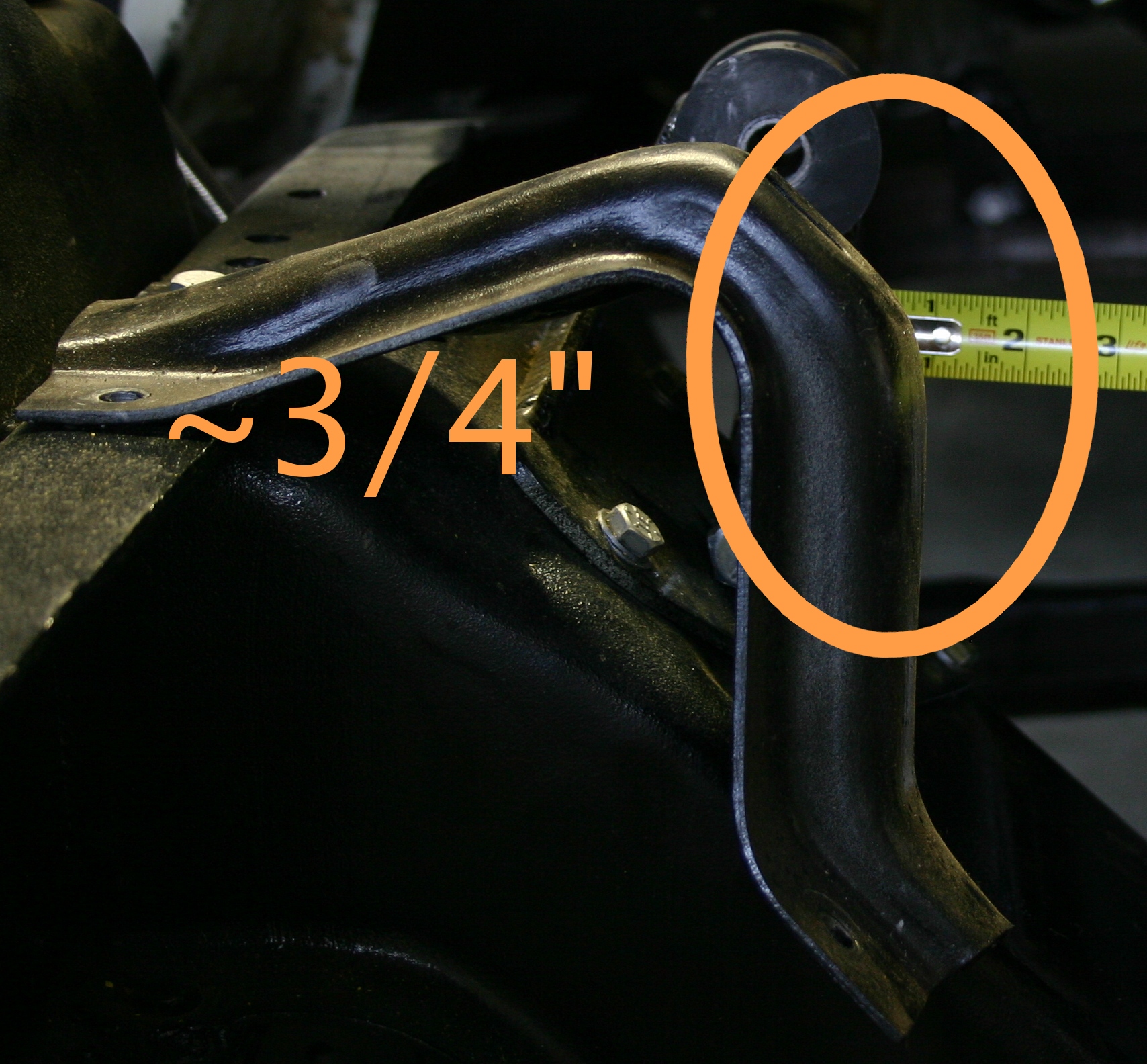

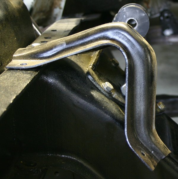

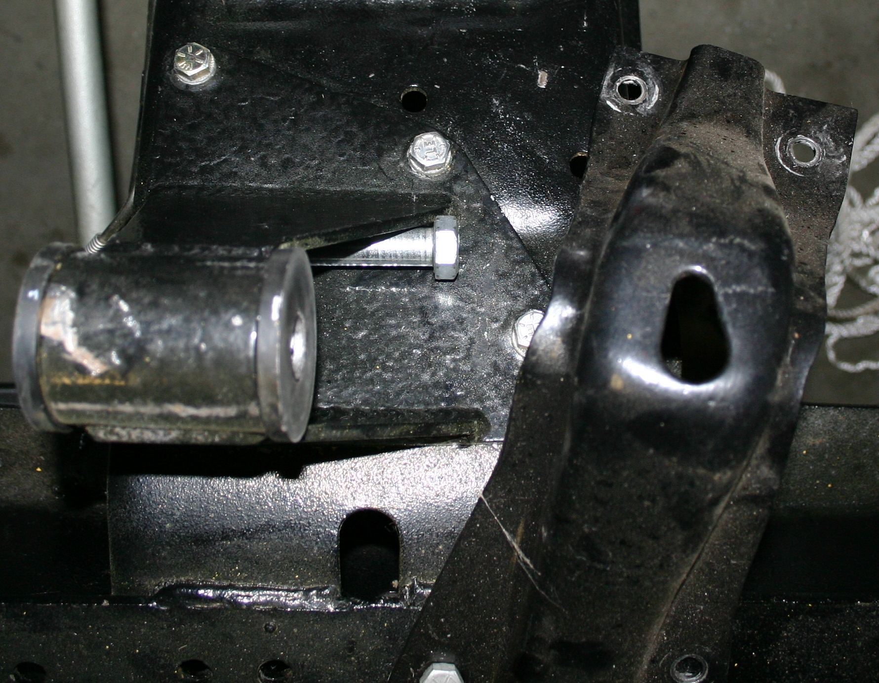

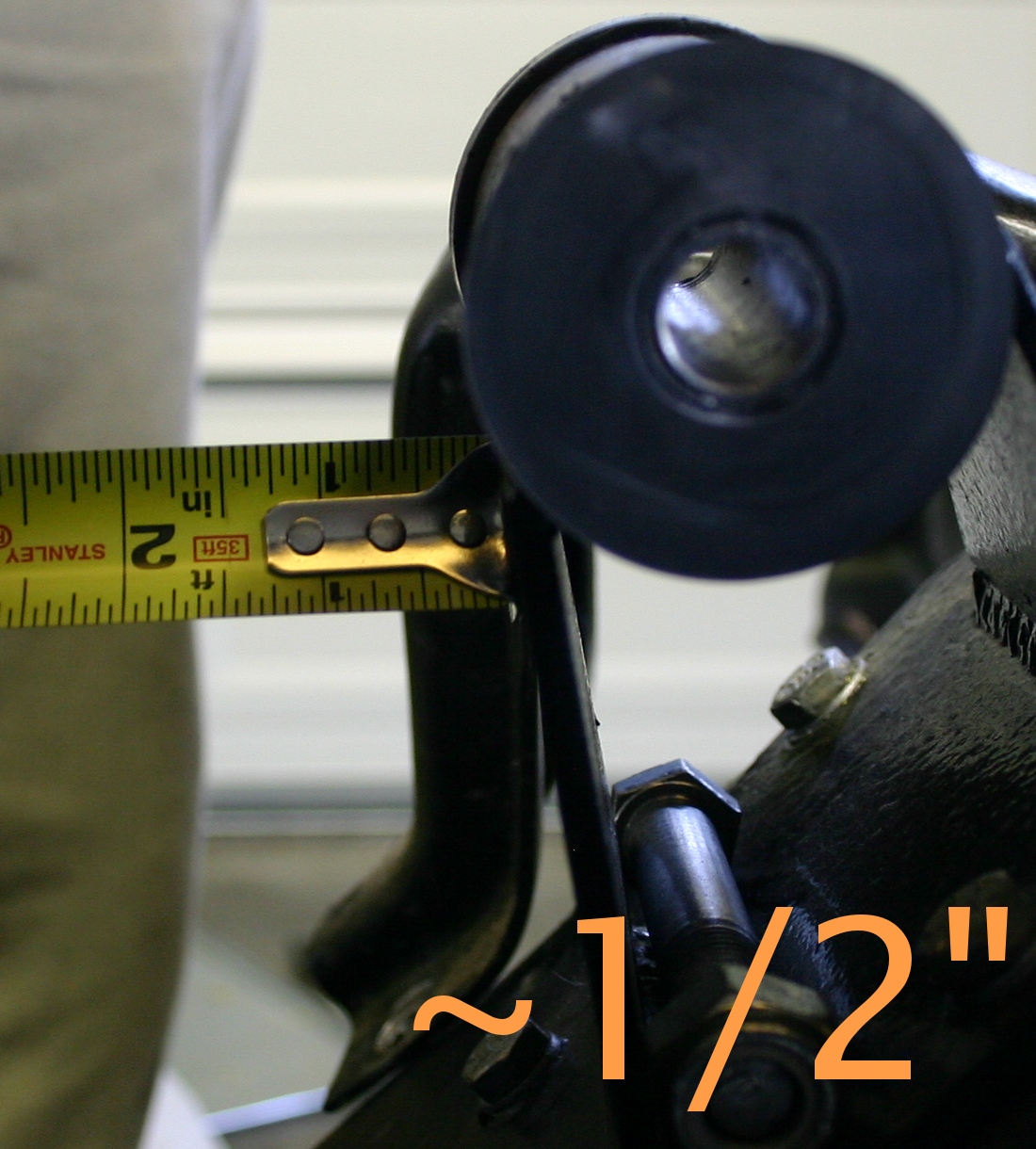

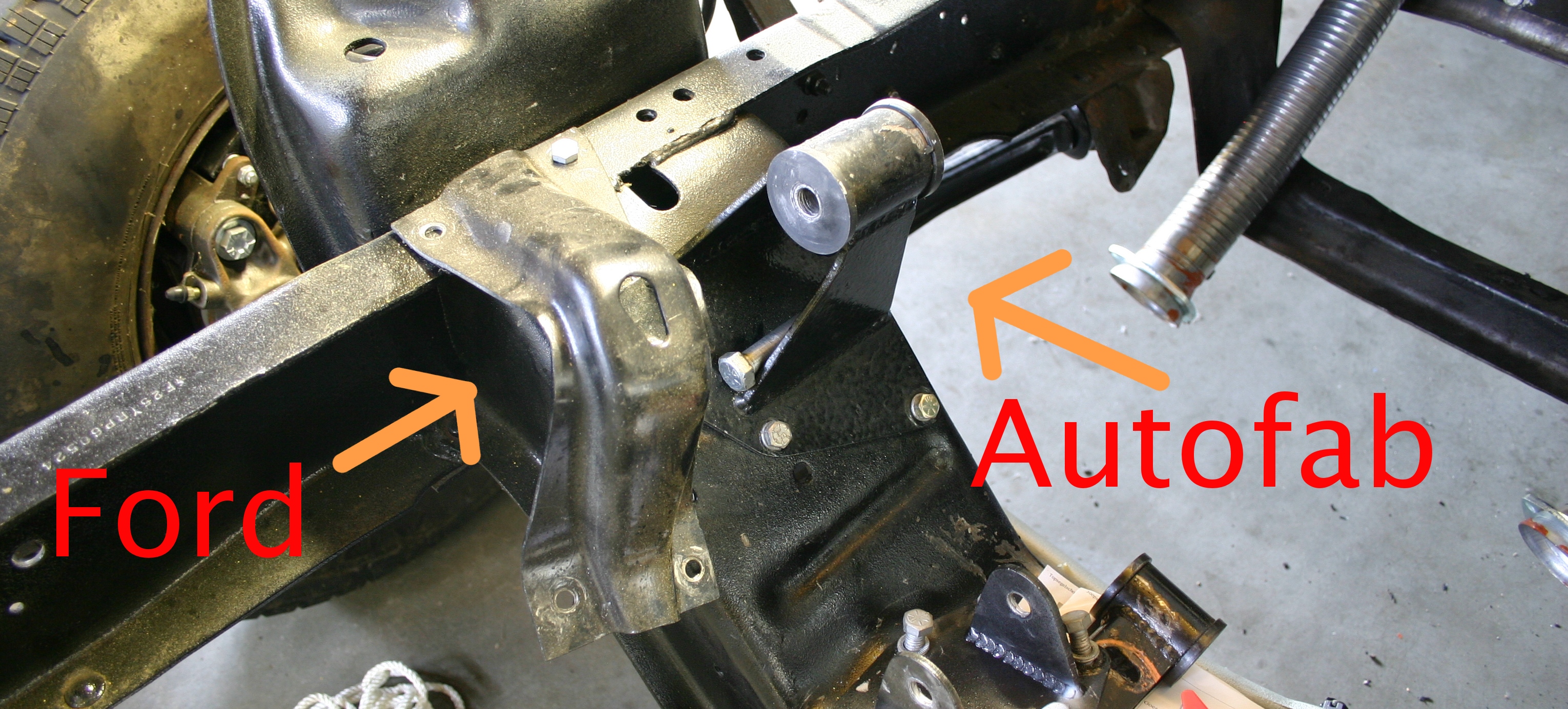

Good evening Dustman_Stx!
Note: clicking on any of these images will yield large editions.

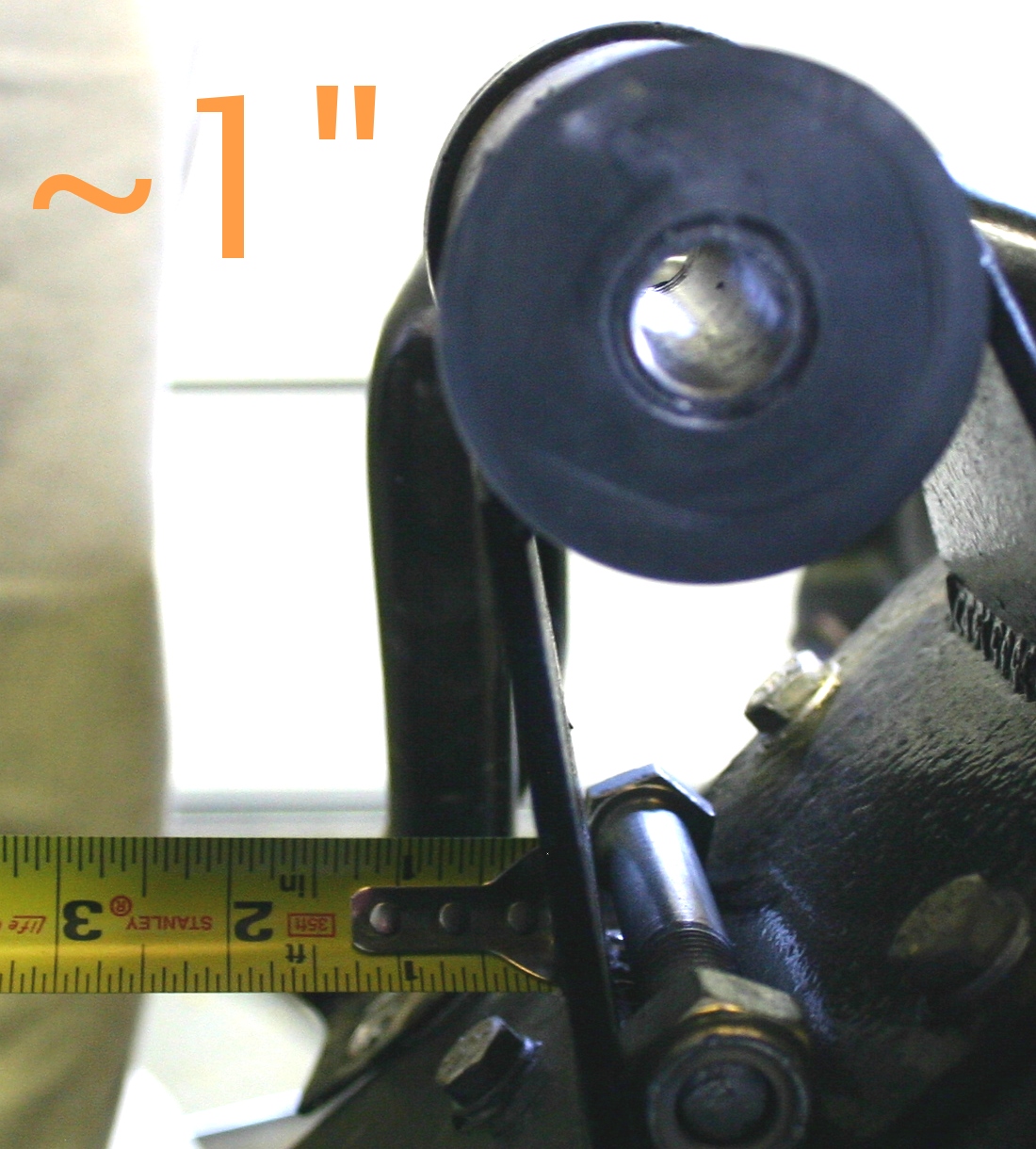

I placed the Ford perch next to the Autofab perch on the passenger side (the Ford perch is held by a loose bolt at the top, and is roughly in its installed orientation, albeit moved forward).
When viewed from the front, you can see that the Ford perch sticks out more than the Autofab perch.
Depending on where the measurement was taken, the Autofab perch appeared to have 1/2" to 1" of additional clearance over the Ford perch. In this photo, the end of the measuring tape was touching the engine-facing surface of the Autofab stand.
When viewed from the rear you can see the same difference.
The additional clearance is most pronounced towards the bottom, and tapers off as I go up.
Here are the perches from above:
Based on this, it appears that there's a chance that the Canton 15-810 will fit! I'm just not sure whether this is indicative enough to warrant the gamble. Needless to say another oil pan swap during my installation attempt would be a hassle (should I loose the gamble), yet it sure would be nice to use an unmodified pan!
Thanks very much for the fantastic and generous advice!
Robroy

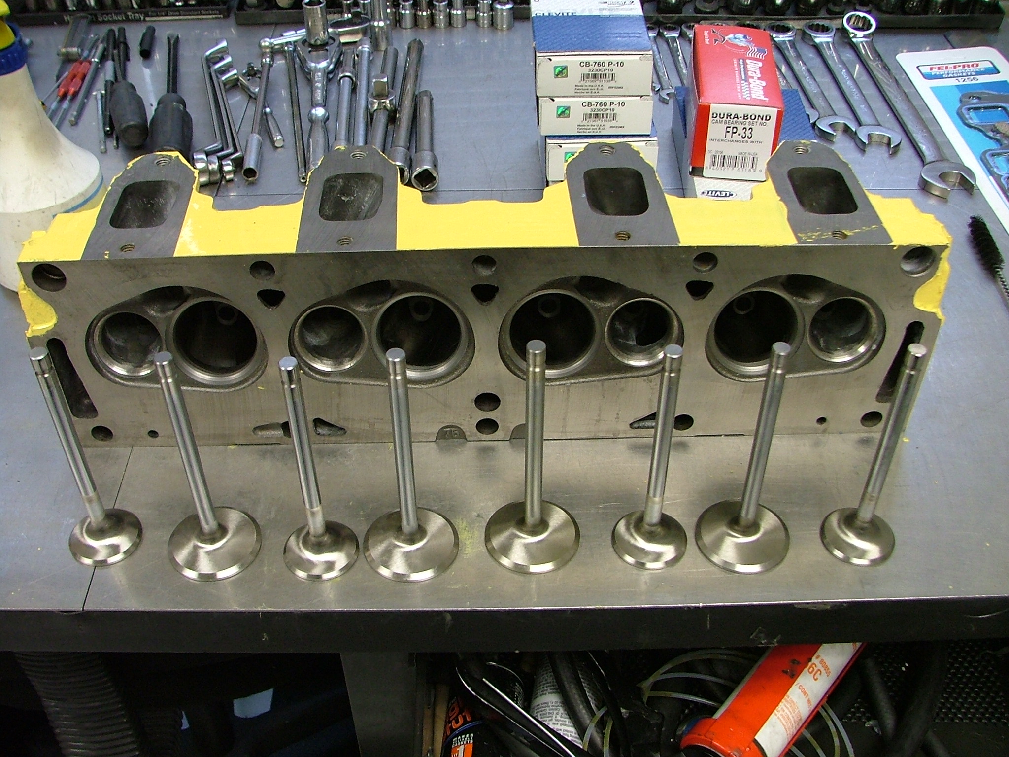

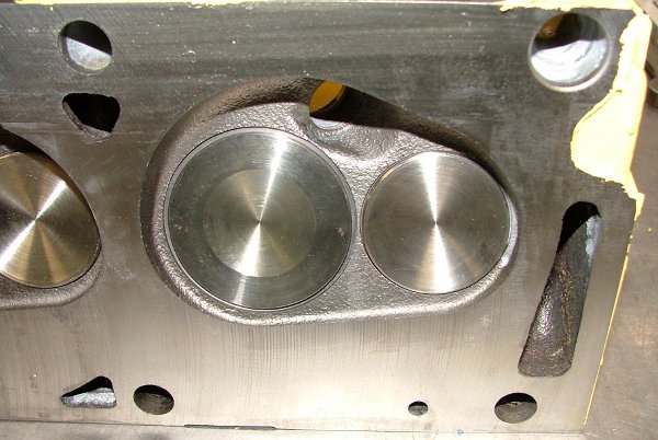

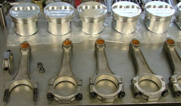

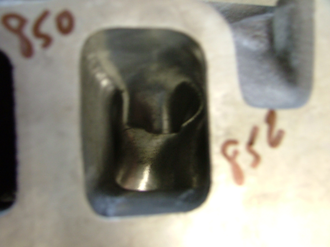

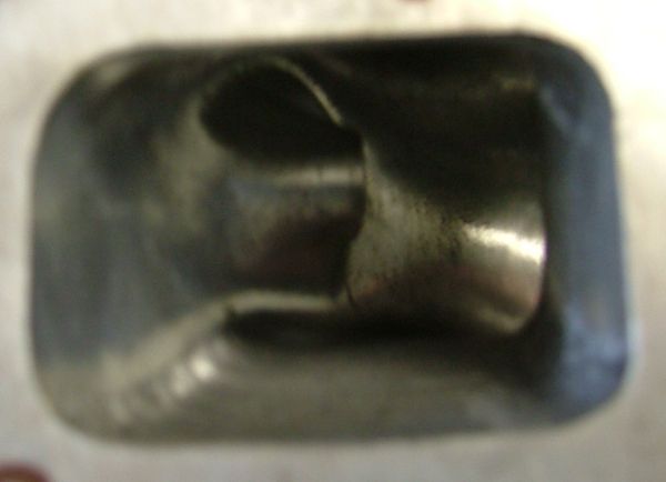

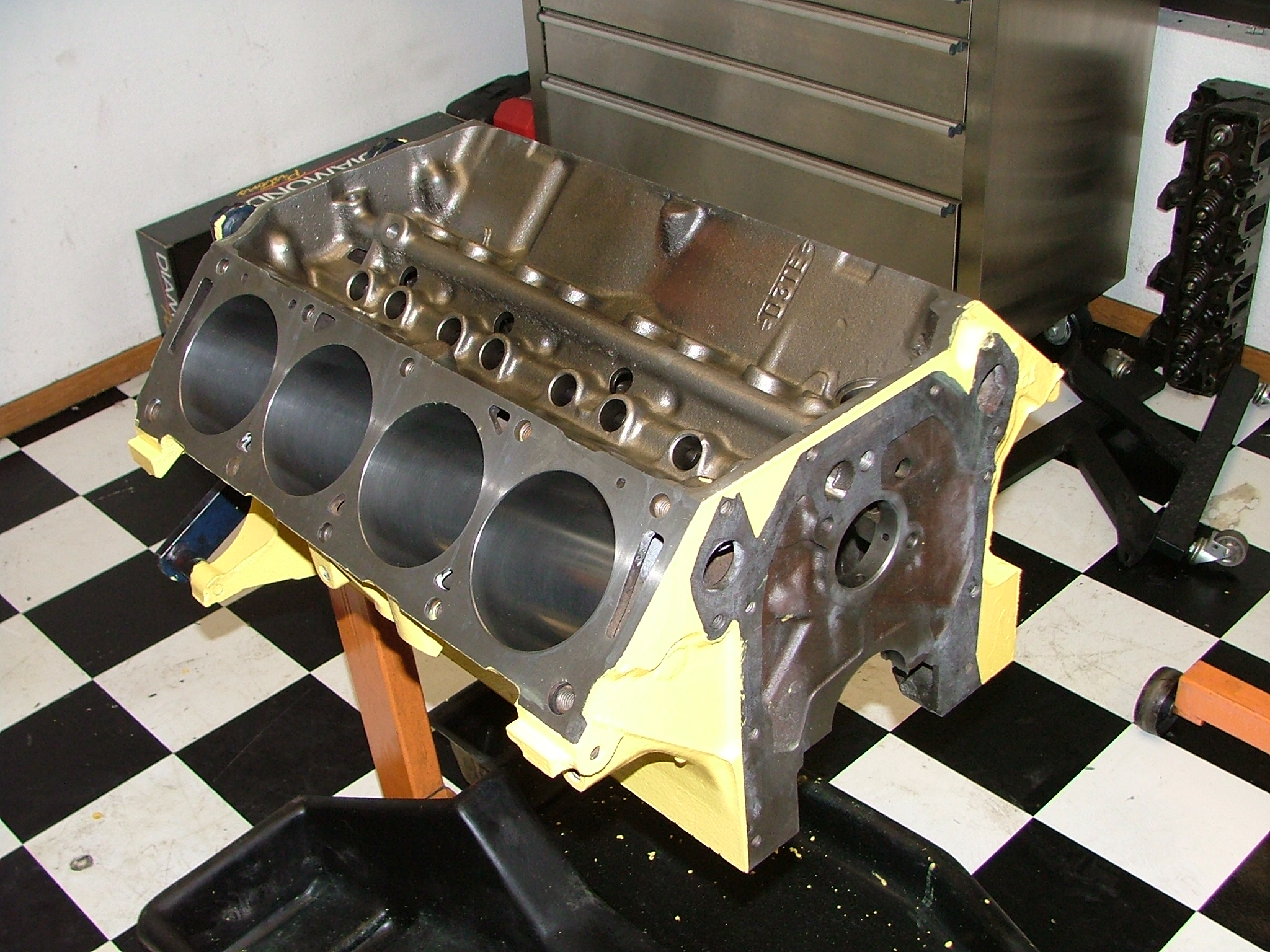

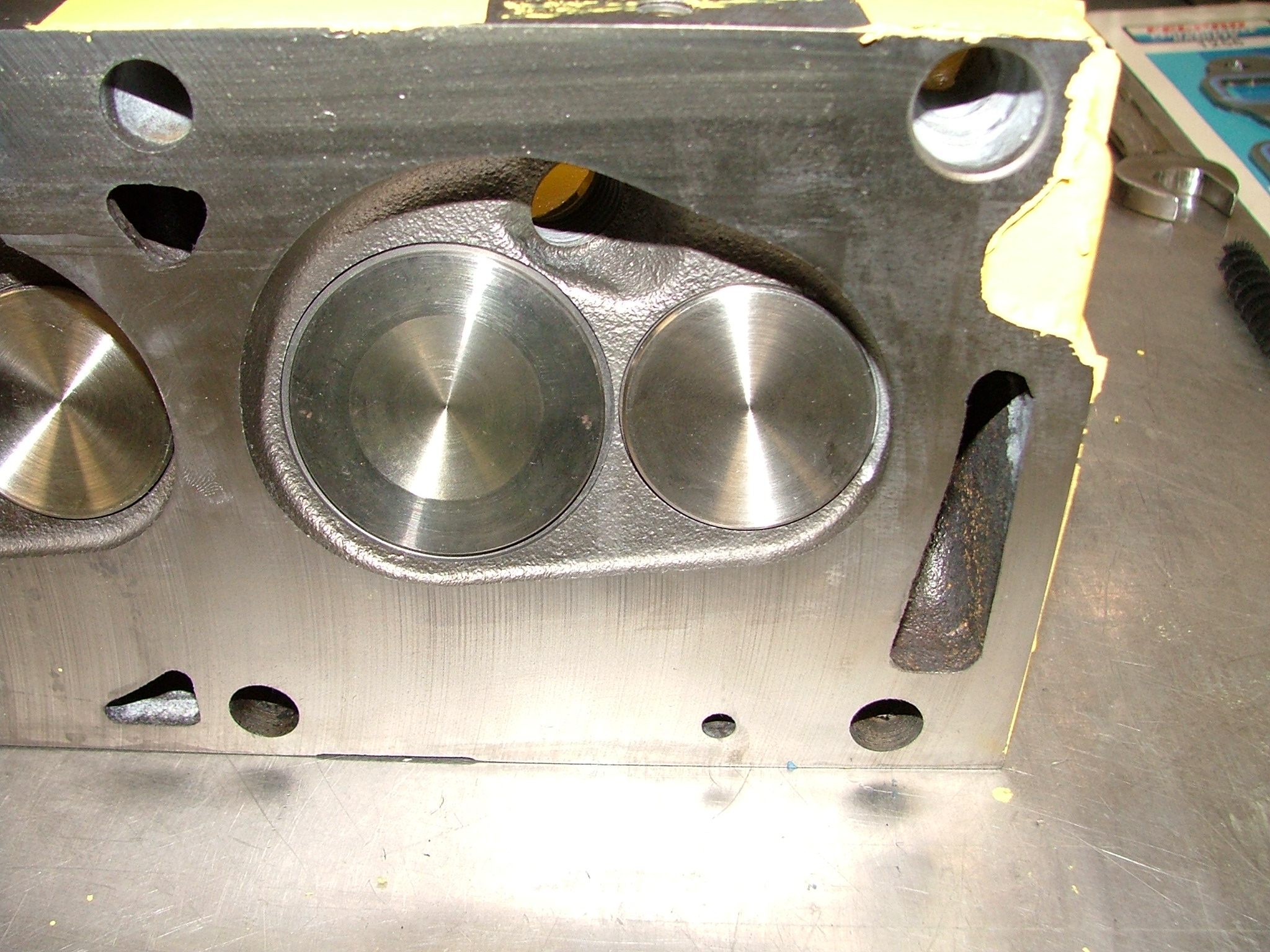

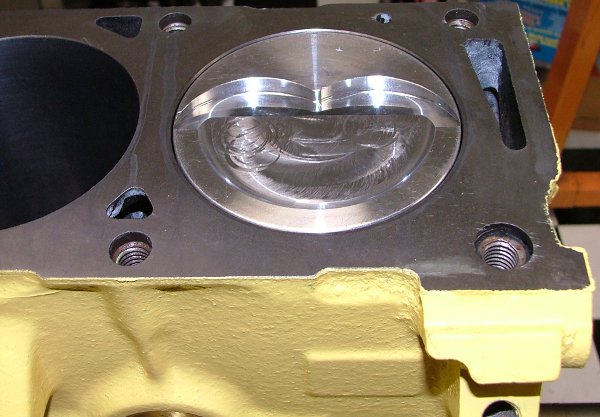

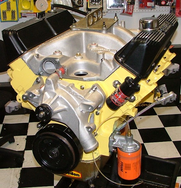

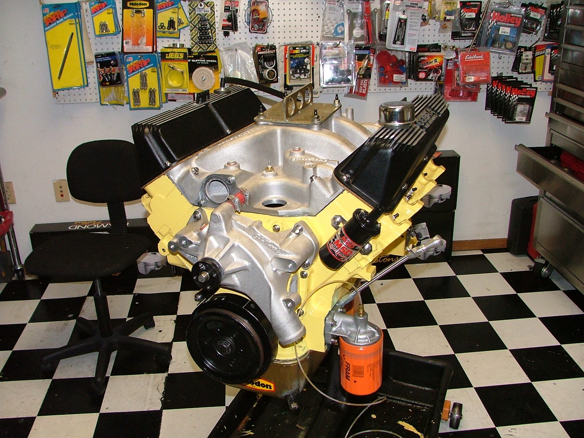

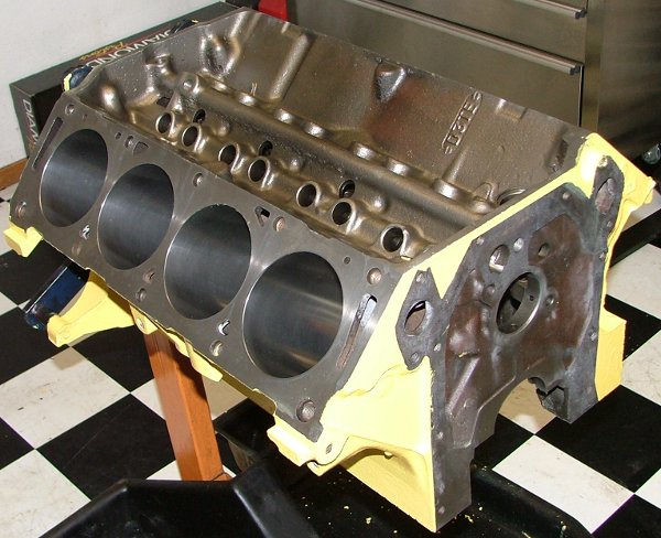

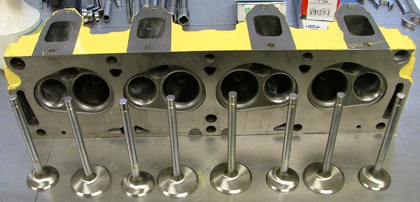

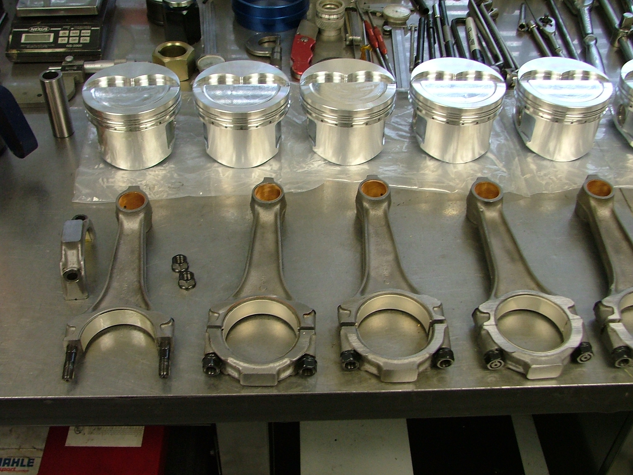

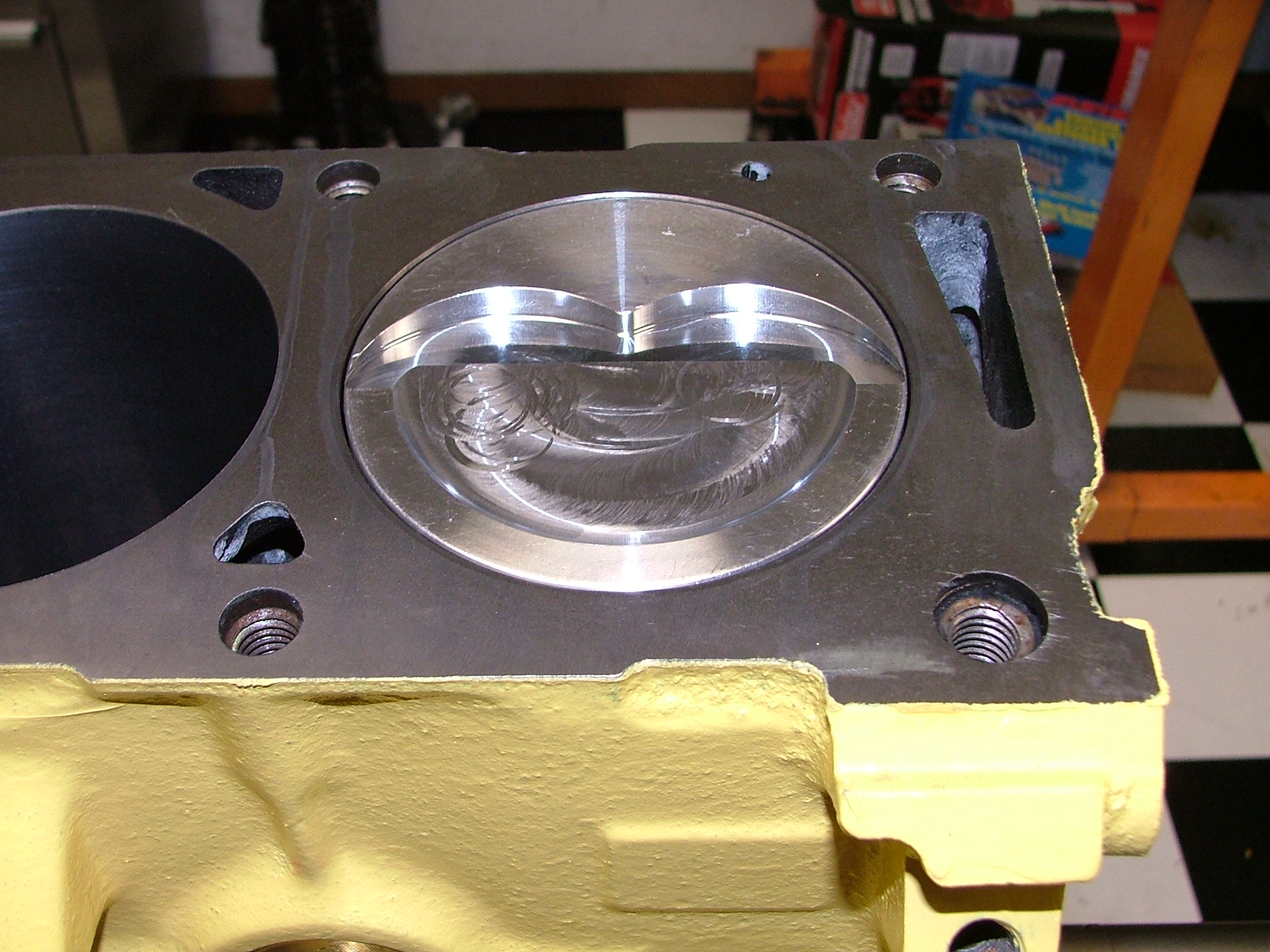

Good day! Here are the photos I received from Tom today. You can click on any of these small editions to load larger, uncropped editions:
Look at these beautiful exhaust manifold surfaces, big stainless valves, and nice paint job! What a contrast from what I had before.
A close-up of the installed valves. It looks museum-like to me!
The cylinders sure look pretty!
Here's one of the custom-made Diamond, 428-sized, forged pistons. What do you think of those marks on the top? I forgot to ask Tom about that during our last phone call, but I might ask next time.
The gleaming pistons and re-done connecting rods! How do you like them?
Here's one of the ported passages--too bad the photo's blurry. I'll have to ask if he has any other photos of the porting work.
And here's Yellow Jacket shortly before going on the test stand!
How do y'all like what's in these photos?
Thanks for your ongoing interest and guidance!
Robroy

Very Nice!!!
The marks on the pistons are nothing to worry about, it is just where the cutter that did the dish started and stopped. "Tool Marks".

I see! Thanks for letting me know about that. I figured that Tom would be highly observant of things like that, so it probably wasn't a problem. It's good to know what the marks are though!DuckRyder wrote:The marks on the pistons are nothing to worry about, it is just where the cutter that did the dish started and stopped. "Tool Marks".
Robert, thanks again for your excellent reply!

FRAM filter??!
