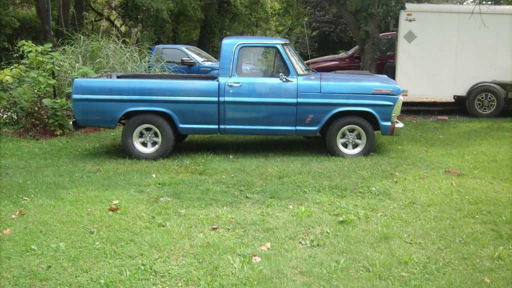

I'm running 17x7 in the front and 17x8's in the rear. 235/60 and 275/55 tire size.

Wow beautiful rig Cole71.
That combo is sweet.(short bed just like mine) Nice taste, all black - really looks good. But I have to ask, did you upgrade your suspension?
Mustang II, Crown Vic swap, spacers? If not, whats the secret? I would like to use my wheels (new in the box) as I mentioned earlier. But im flexible and can spring for a new set if I have to.

Thanks for the compliment!
Truck is lowered with DJM Dream Beams with a coil cut out of the springs in the front. The rear has a full hanger flip with the helper spring removed.
I opted to re drill my rotors (switched to power discs) and drums and axles.

15x7 on front 15X8.5 on rear 225/70/15 on front 285/70/15 on rear stock ride height

Good looking rig. I like the Torq thrust Ds! Stock height still looks great. Thanks for your input!
